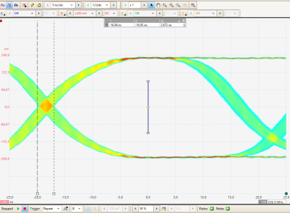

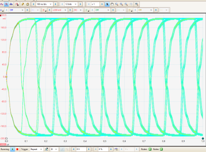

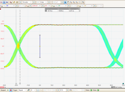

to get an eye-pattern. An ordinary RCA analog cable used, terminated with 50 ohm and a PicoScope 4444 oscilloscope working with 20 MHz BW.
48 kHz:
96 kHz:
192 kHz:
Any thoughts? :)

I know, but I was getting much worse visualization when terminating with 75 ohm. Maybe the cable I've used is closer to 50 ohm. No idea what's the impedance usually for analog RCA cables.
A short explanation - I'm trying to figure out how a cable can influence the carrier jitter and noise for different sample rates.

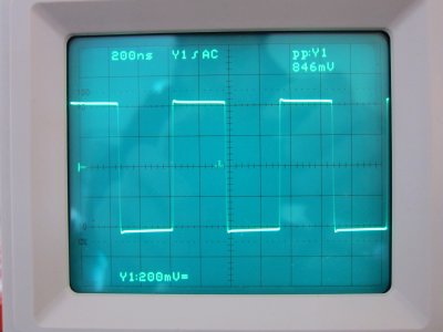

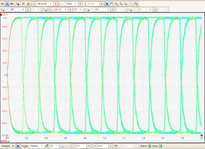

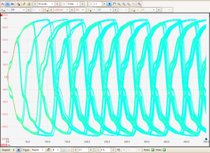

Different cable, still 50 ohm, different triggering.
48 kHz:
96 kHz:
192 kHz:

It's a standard spdif output but impedance mismatch - 50 ohm termination plus a cable - probably affects a voltage.
I know I won't get a square wave representation, I don't expect this. But I think the noise and jitter can be still observed on the pattern.
