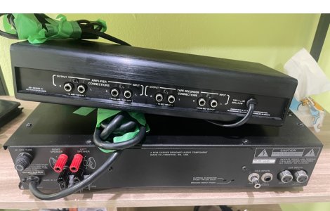

Hi Everyone,
I’m thinking of using Wiim mini with Bose 901 speakers + Bose EQ, powered by Carver PM 350.
My question, how can I hook this set up (see picture) to the Wiim mini?
Your suggestion are greatly appreciated.
Many Thanks,
T

This is a better place for your question, but frankly speaking, you should have started your own thread, adding Bose 901to the title, to gain more attention.
I have no idea haw you are going to connect that Bose EQ thingy to the Carver power amp. It looks like the Bose is designed to be included in a pre-amp's or integrated amplifier's tape loop. Do you have RCA to XLR (or to T.R.S.) connected to the "amplifier connections output"?
If the 901 needs that EQ box in place then (in the absence of a pre-amplifier) there is only one way to connect the WiiM Mini: 3.5 mm stereo jack to RCA cable from the Mini's aux out to the Bose's "tape recorder connections input".
Yes I agree with @harkpabst . I replied to your post in the configuration thread, btw
