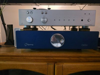

I control the volume for my system via the Ultra because I'm utilizing the sub out feature.
I run it into a preamplifier them into an amplifier.
My amplifier has its own gain knob on the front.
With this many volume controls I'm wondering how to adjust everything for maximum fidelity?
I currently have the preamp volume at about 1:00 and the amplifier volume at about 3:00.
Van Alstine Fet Valve CFR Preamplifier
Odyssey Cyclops amplifier with Extreme upgrade

The way I'm interpreting your reply is that the preamp should be up fairly high and use the amp gain to dial it in?
I would say yes, but being careful on not to overdrive your power amp as the ultra has gain and then also your preamp.
You could start with ultra at 100% (sub off) preamp in 0% and power amp in 40-50% and start increasing the preamp until you hear distortion, back up a little on the preamp pot and you have a nice safe point. If you will never go to 100% in the Ultra then you can do the same but with the max you plan to have the ultra.
Use a difficult track to test, cant imagine one now, others might chime in and also propose faster methods hehehe.
You could try the Ultra directly to the power amp also, it will have enough gain to drive it, but if you have other sources connected or you use it for the tube sound then probably not feasable for your use.

Thanks.
I was running it that way before I got the preamp.
The system sounds much better with the preamp.
I'm driving vintage ADS L1090 speakers.
