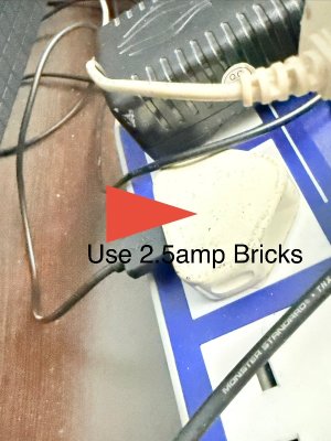

To those who have disconnected issues on WiiM Mini after updating the firmware. Been going through super nightmare to reset, rebooting & keep asking to reset the WiFi router. It still doesn’t work.
Finally found out to change the power brick to 2.5amp. Then only problem solved. WiiM should advice the community to do that after updating the new firmware SUCKS !!! WiiM should come with the 2.5amp power brick. Pretty disappointing to solve this issues.
