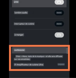

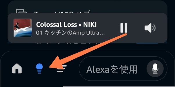

It appears you are viewing a different screen.
Please tap the light bulb icon in the menu at the bottom of the Alexa app's top screen, then tap the group card in the topmost group section.
Tapping the group card displays the devices within the group as shown here. At the bottom, there is an option to select the priority speaker.
Translated using Google Lens.
If the same screen does not appear, please ensure the Alexa app is the latest version.
