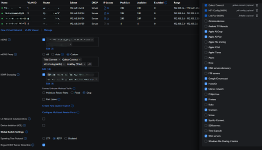

I have noticed that my Unifi firewall between the WiiM Pro (IoT-Vlan) and the WiiM App (LAN) is blocking the receiver port 22809. Does anyone have any idea what it is?

That's not the problem, I just wanted to know what port 22809 is for. Because I couldn't find a hint anywhere.
