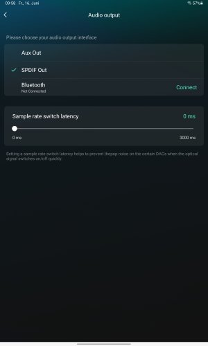

I am having this issue too. It seems to be a fade in that’s been programmed in. It’s been reported in other threads for some time now. I don’t see why they can’t just add a switchable setting to turn this off. It occurs for me using Alexa cast as well as playing Amazon Music through the native WiiM interface. It occurs both when I select a track and at the beginning of each sequential track of a playlist. Albums do not have this problem and gapless albums play nearly perfectly. It’s quite annoying.
My device was originally configured with this sample rate switch latency set to zero and I was experiencing the fade in effect at that time. I increased this latency setting to 80 ms for a bit and later even turned it up to 500 ms. The fade in was still occurring. Then after Frank replied back, I switched it back to zero. The fade-in is now gone. Other possible reasons: one of my iOS devices had an old version of WIIM home installed; a version that did not show the sample rate switch latency setting at all. Also restarted the WiiM mini a few times at various stages of this. Thanks @Frank86 !!!
