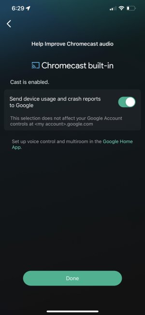

Just setup Wiim Pro - advertised to work with Google Home and Assistant. I have Chromecast built-in enabled. When I click the link to set up voice control and multiroom, it takes me to the Google Home app. Where do I go from here? Google Home doesn't detect the device and Wiim is not listed under "Works with Google".
Thanks in advance!
