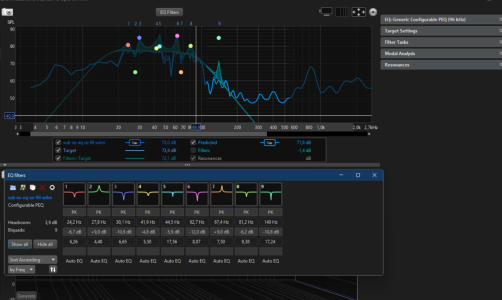

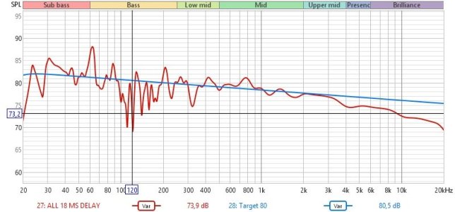

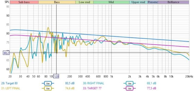

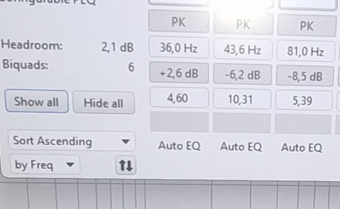

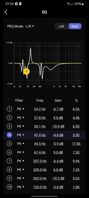

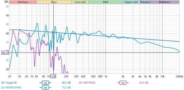

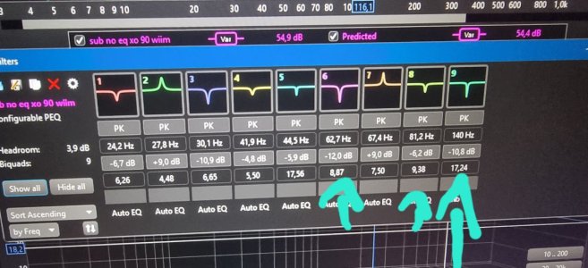

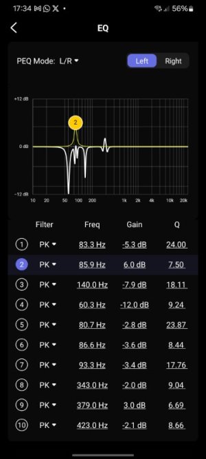

So I was tuning my system and I noticed my speakers are actually good from 60 to 120 hz where the sub is good but it has some dips which can't be fixed due to room.

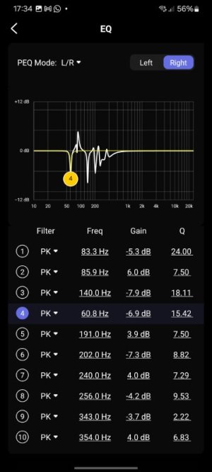

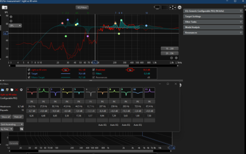

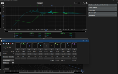

So I bypassed speakers and subwoofer in sub out page and use internal subwoofer amp for its crossover and the 3 peq bands it has. then I went onto the LEFT and RIGHT speakers individually, so I could EQ them , but I also had to use the first PEQ bands of LEFT and RIGHT to EQ SUB cause I really needed 6 bands for Subwoofer.
Problem:
EQ for subwoofer is affecting speakers, and EQ for speakers is affecting Subwoofer.
Please give us seperate PEQ bands for SUB OUT.
and if possible since we can bypass either speaker or sub or both also give the opurtunity to set crossover in sub out page for subwoofer and speakers individually.
ps: although I did notice EQ is sometimes not applied unless a reboot in wiim is done.
Best regards and thank you for the amazing device that wiim ultra is.
