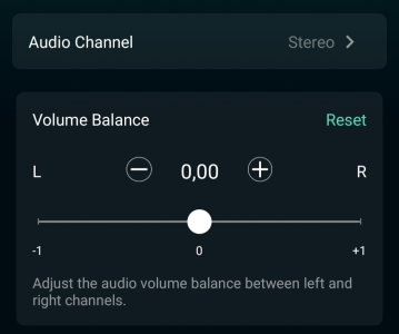

In the WiiM Home App open the Device tab, hit the settings gear and head over to Audio Settings.
Is the balance slider set to 0 and Audio Channel set to Stereo?

Yes checked those settings set to stereo and set to 0 for balance
