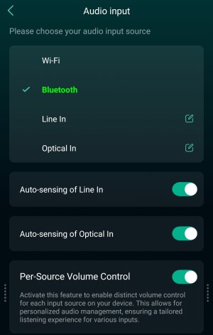

When I checked this screen all the settings were off. I turned them on and still no soundView attachment 5790
