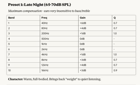

I’ve used the room correction feature on my WiiM Mini to give a custom EQ. I mostly listen at relatively quiet levels and would like to add a “loudness curve” on top of the custom EQ. Ideally this could be variably set so I can set th curve to max when listening very quiet, turning down as the volume increases.
Is there a loudness option on the WiiM, or a method to implement one?

… or simply have a couple of configs to choose from. Good enough for most of us - if we need to have it at all.
Indeed. It doesn't necessarily need to be an exact calibration, but there should be a way for the user to adjust the reference point.
E.g. someone might decide that they want bass to be flat when they set volume to 63%, because that is nice and loud in their environment, and to get progressive bass boost when they lower the volume from there. For someone else that might be at 30% or 95% volume.
Those that have SPL meters can even translate the calibration to a specific SPL.
Akin to roomfit measurement?
RoomFit doesn't require any knowledge of absolute sound pressure levels, but Dynamic Bass/variable loudness/however one calls it does. Room correction only makes sense within the limits of system linearity, but Dynamic Bass really attempts to deal with the non-linear behaviour of human hearing. I think these are pretty different use cases.
Yeah, but that wouldn't be much different from what we have already: GEQ profiles like Loudness, complemented by Loudness 2, Loudness 3 ... which you could create yourself right now. I'm not the biggest supporter of variable loudness (because I think that it is often misunderstood), but if you want something like that, it has to be dynamic, variable, automatic ...

I just meant from the point of view of using a mic at the listening point - couldn’t it determine SPL in the app?
It might if the microphone calibration file includes sensitivity, and if the app knows how to interpret it correctly.
E.g. miniDSP UMIK-1 cal file includes individual microphone sensitivity factor, and REW can interpret it.
