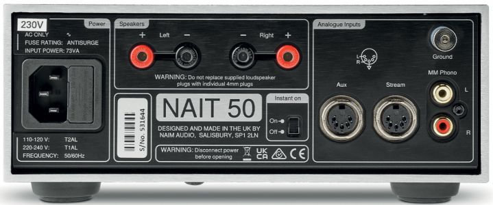

I, however, have found that mine introduces horrible hum into the phono stage of my Naim NAIT 50 amplifier.
After hours of plugging and unplugging the only way to rid the phono stage of the hum is to completely power off the Ultra. No amount of moving the ground wire from amp to Ultra to mains ground would fix it. Quite simply if the Ultra was plugged in, the hum found its way to the phono stage. Disappointing but from what I've read here there may be some real concerns about the Ultra and its grounding.

I've tried the Ultra into both the DIN inputs. Even with the Ultra bit connected to the amp, as soon as I power up the Ultra, there is hum on the phono input of the amp. It's like the Ultra is producing noise on the mains that the phono stage is picking up. As soon as I unplug the Ultra from the power, the hum disappears.
