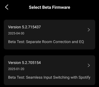

The latest beta firmware is dated April 30, so if there is a problem with the latest public FW, it may not be resolved. have you already tried the January 20 version?
That is a one thing I missed to try indeed! Will try asap and check if it solves the issue already. Thanks!

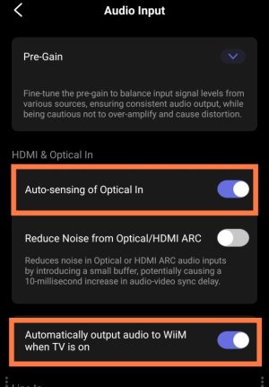

Also, please try turning the 2 toggles on / off several times on the audio input screen of the WiiM app.
January 20 beta version has also the same behavior now. I start to suspect that the TV has a problem with its Arc output. I will try to connect the TV to another set of speakers directly via Arc and see the problem persists.
