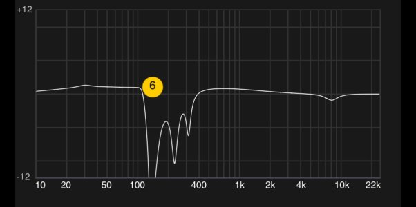

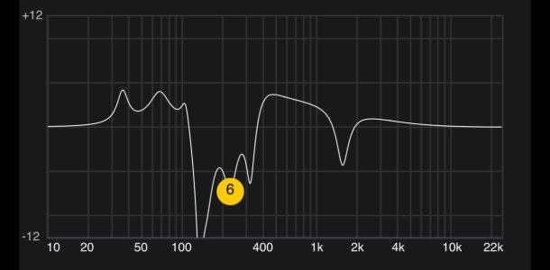

I measured my living room today and compared the results with iPhone 16Pro vs. UMIK-1.
They look different and they sound different, I prefer the UMIK-1 result.
iphone 16Pro:
UMIK-1:
Cut-Only Mode has not been used with the UMIK-1?
Honestly, I would have expected a difference, but not in this way, with various ripple-like peaks disappearing.
I did not use the Cut-only mode but limited the max gain to 3dB (iPhone) and 1dB (UMIK-1). It is nearly the same but not such strict, Cut-only mode would mean max gain = 0dB
This may explain the different height of the hump but not the ripples. I would see this as an acoustical effect with the iPhone's microphone. Its assembly in a small rectangular area is less optimal, in no case it can have a rotationally symmetric frequency response anymore. So it records sound from different angles in a different way. I assume this as the source of the ripples with the worst case around 1.6kHz.
No, not in the same sense as setting max gain to 0 dB.
With Cut-Only Mode enabled and Max Gain set to e.g. 5 dB, individual peak filters can still use positive gain. But the gain of all filters combined will be <= 0 dB.
I'm quite happy with Cut-Only Mode so far (except for the name).
The differences in that middle range are more likely to be variation in room interaction between the location where the UMIK-1 was placed versus where the iPhone mic was placed. Typically, it is on the very lowest bass and also the very highest treble where the proper mics like UMIK-1 show significantly improved accuracy over phone mics, which are cost-optimized to focus on midrange accuracy and clarity over extension.
