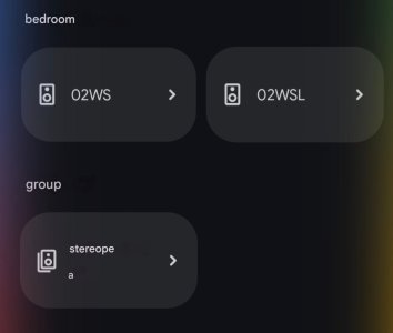

At least my WiiM Sound is added to the room via Google Home. Additionally, a "stereo pair" group has been created with WiiM Sound Lite, allowing casting via Spotify Connect.

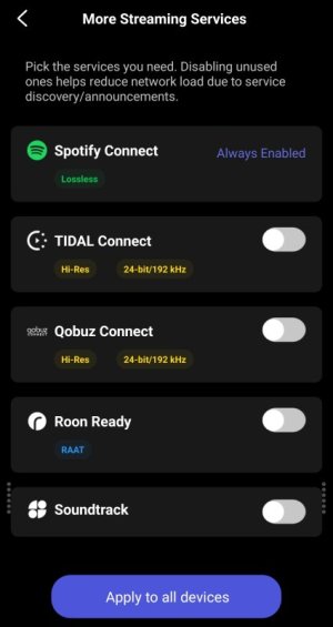

If this doesn't work, you may need to factory reset the device, set it up again, and enable Google Cast. I don't know anything about Roon, but is Roon Ready enabled in the WiiM home app?
I have enabled Google Cast. My WiiM Sound appears as a Chromecast device in my apps and can play music using WiiM Home, Roon, Qobuz, etc.
I just can't find a way to add it as a device within the Google Home app, and any Chromecast group that includes my WiiM Sound won't connect in any app even though the groups appear as devices in Spotify, Qobuz, Roon, etc.
I have enabled Roon and it has no problem playing to only my WiiM Sound. But when using Roon Ready I cannot group the Sound with my Ultra using the WiiM app.
