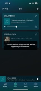

When I want to play multiroom speakers, error message showed with “upgrade firmware”
But wiim pro Already upgraded latest version.(4.8.5)
How can I fix it?
Firmware version is 4.2.8505.630
And I think this is the very new version.
What else I can do?
I have three another device that after update them to newer firmware start to work in multi room,before new way of multi room they work in their hotspot,new way of multiroom work via router and you have long range of connection,another floor for example.you have a lot of firmware that work with your Vifa device,if you want try from deferent brend if you know to update via update tool for windows for linkplay device.
Your firmware is old from 2020 07 05,you must have newer firmware
