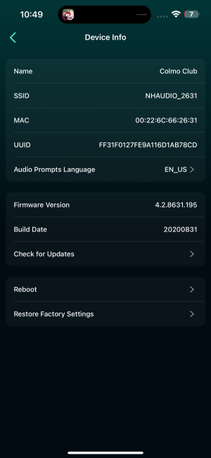

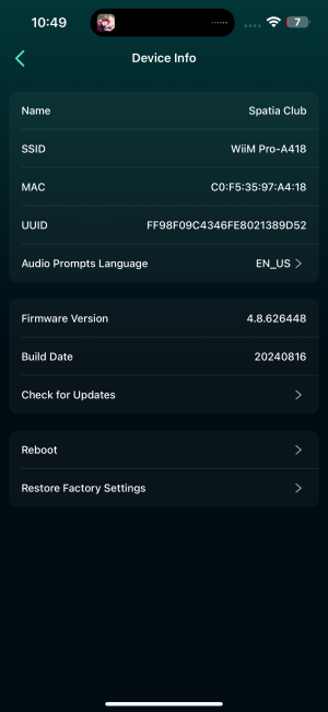

Hi,
Can’t synchronize 2 WiiM pro. When I try to upgrade firmware both say up do date.
Any help ? Thanks !
Hi,
Any help ? Thanks !
"Colmo club" firmware version and build date is clearly abnormal, please submit a ticket via the feedback section of the WiiM app.
Perhaps a factory reset is needed.
