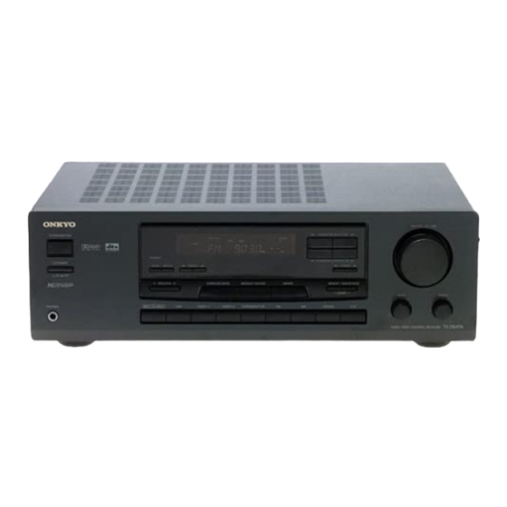

I have a question for those who are more knowledgeable than me in the hi-fi field. I have a Wiim Pro along with a Topping E30 II. My amp is an old Onkyo TX DS-474. I ask if you get better sound by combining the two devices or if the Wiim Pro alone is enough to have more than good sound. I mean, with the combined Topping do I improve the sound quality or not?

He means connect the WiiM Pro by optical directly to the Onkyo but he perhaps doesn't realise that the Onkyo is old and that it's DAC chip is probably inferior to that in the Pro let alone the one in the Topping and probably limited to 24/96 if not 24/48.
My advice (in order of preference but 1 and 2 could be reversed).
1. WiiM Pro Optical out -> Optical in on Topping -> RCA in on Onkyo
2. WiiM Pro Coax out -> Coax in on Topping -> RCA in on Onkyo
3. WiiM Pro RCA out -> RCA in on Onkyo
4. WiiM Pro Optical/Coax out -> Optical/Coax in on Onkyo

No, try optical directly from the Wiim to the Onkyo. I can't find any detailed info on the Onkyo DAC but it seems to support 24/96.
Hi, @Maurizio53.
I don't think your Onkyo receiver has a "direct mode" to avoid DSP. Presumably, all inputs of the receiver will use the built-in DAC.
For this reason, as @FreakyKiwi said, you have the advantage of being able to avoid the ADC by using the digital input of the receiver. However, as @d6jg said, the receiver's DAC is old, so I can't really tell which one has better sound quality.
In any case, enjoy all the connection methods. 😊

I don't think you can avoid the receivers DAC as it will probably be an audio path through the receiver like this
RCA - ADC - DSP - DAC - Amp - Speaker
even when using an external DAC.
You can avoid this, and the redundant Wiim or Topping DAC stage, by going direct digital from the Wiim to the receiver.
Wiim: digital out
Receiver: digital in - DSP - DAC - Amp - Speaker
Maybe the Topping DAC will add some magic and the receiver's analog audio path will be transparent, you can only try it out and see.

Direct mode may bypass the DSP (i.e. no eq, no bass management, no timing adjustment) but do you really think it it bypasses the digital audio path (ADC and DAC)?
I can't believe the design is complex enough to allow switching to a direct analog path.

I read the manual for TX DS-474 but I couldn't find the direct mode. Am I missing something? 🤔
