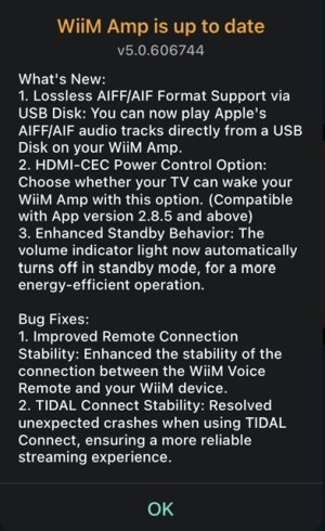

New firmware v5.0.606744
Just had the update, Spotify not working anymore.
Sub out seems not to function anymore as well...
Think the Spotify issue isn’t restricted to WiiM devices - my echos and fire tv won’t connect either

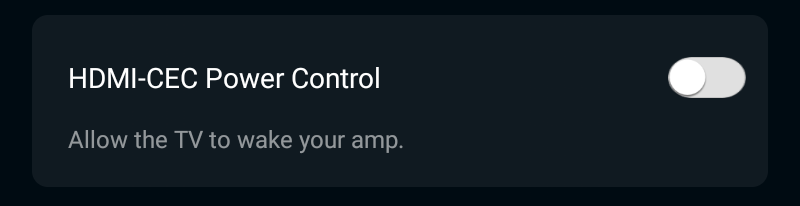

Really pleased to see the HDMI-CEC power toggle implemented in this new firmware.
I reported an issue with this aspect of HDMI functionality recently and WiiM confirmed that they were considering implementing this change, and now here it is.
Excellent customer service I would say, thanks WiiM!
