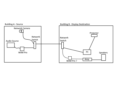

So sorry - just to clarify - do I need TWO WiiM Pro units or just one at the encoding side? Below is a diagram of what I am trying to do. Is there a way to sync the audio to the video coming off the network camera?
You'd need a WiiM device at both ends - the source WiiM wouldn't be able to see your PC as a target device/speaker. Re sync, the WiiM devices couldn't do that themselves, you'd need the camera or PC to do that if possible similar to the lip sync feature you'd have on a TV or AVR
