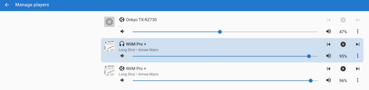

Thanks for the additional details.
I'm still very much a noob, and only now discovered that when with the LMS UPnP plugin, there is an option to select the UPnPBridge player of the WiiM Pro+, which will convert a Apple Lossless (alac) file to FLAC format. Conversely, if I set File Types for "Apple Lossless" to "Disabled" and then use the SqueezeLite player, the same alac file is converted to FLAC.
Last question (I promise): if I use the WiiM Home app as the interface to playback the content served by LMS, is the WiiM Pro Plus playing the alac directly (ie, no conversion)?
I'm afraid it's not something I know off the top of my head, but I'd imagine so.
I'll try and have a look tomorrow if it's still unanswered.

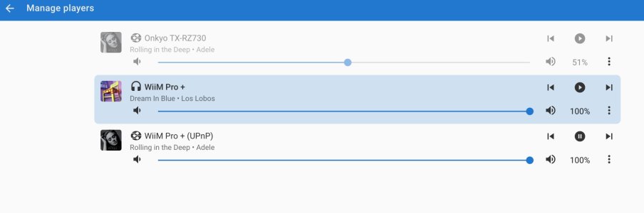

Thanks for pointing me to that thread. I had perused it the other day when I first noticed the problem. My conclusions and actions after all of the help from you and @simbun are:
  1. Any file type which contains Apple Lossless Audio Codec (ALAC) content will not be pass-through to the WiiM Pro Plus "as is" for playback because the Squeezelite player implemented by the WiiM Pro Plus cannot currently process Apple Lossless.
  2. I haven't gone the rabbit hole to understand why the WiiM Pro Plus needs a separate "player" since I assumed that it was the player, just like an audio receiver.
  3. The WPP and my Onkyo receiver can playback an Apple Lossless file when I pull it from the LMS server using these devices' app.
    • The same Apple Lossless file won't play when I push the same file from the LMS web interface (Material skin).
    • Filetypes which contain ALAC content are m4a
  4. Via UPnP , LMS will push a flac converted version of Apple Lossless files if I activate the UPnP Bridge plug-in.
    • I've named this player on LMS "WiiM Pro + (UPnP)"
  5. Via Squeezelite (ie, the default "player" for LMS used to push to WPP), I have changed the File Type setting for "Apple Lossless" to "Disabled."
    • I've named this player on LMS simply as "WiiM Pro+"
    • I suggest changing the name "Apple Lossless" to "Apple Lossless Audio Codec (ALAC)" to help noobs like me understand where to change the settings for "lossless .m4a" filetypes.
      • For instance there are other File Types listed which confused me: "Apple Lossless leading audio," "MPEG-4", "MPEG-4 SLS / HD-AAC"
  6. There is no equivalent of "Passthrough" audio that would let endpoint devices (Onkyo, WPP) play the native file type.
    • In the settings for the UPnP Bridge plugin, I changed the option for "Audio format to UPnP player" from "auto" to "none" hoping this would pass-through the ALAC stream, but unfortunately this doesn't work either.
Bottom line #1 - The above seems the most flexible solution for playing ALAC files on my WPP and receiver.
Bottom line #2 - Even with this significant issue (now worked around), LMS is a great companion with the WPP.

Yes, I can play the ALAC files through Squeezelite ("Player Model: SqueezeLite; Player Type: squeezelite")
if they are converted to FLAC. To help clarify which protocol applies when I activate the UPnPBridge plugin, I've renamed the WPP player which utilizes the UPnP protocol. See screenshot below. I use UPnPBridge plugin so that I can use the Material skin to listen to music on my Onkyo receiver.
  • FYI, I don't Disable any other File Types
This setup also gives me the flexibility of pointing the WPP and a network-capable receiver/integrated amp to the LMS on my NAS. In this case, I use the WiiM Home app and the receiver's app (which are not as nice as the Material skin) to select music. ALAC files play flawlessly if I pull them in this manner.
