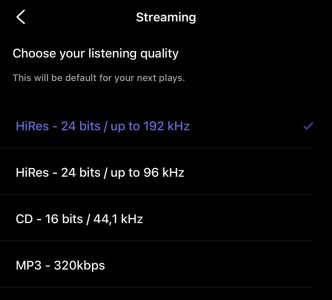

These are the sound quality settings for Qobuz in the WiiM Home App.

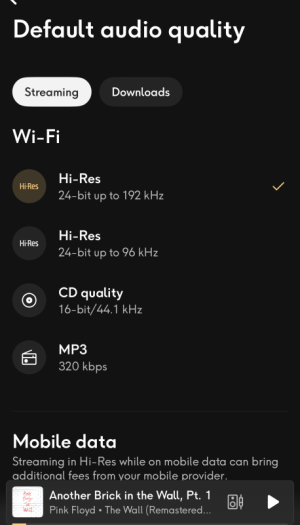

Still possible under the cog settings icon on the Qobuz tab under streaming for both my iOS and android WiiM home apps.
