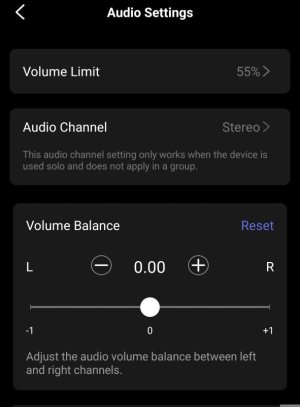

- checking the balance through the wiim amp as it could have mistakingly been moved entirely to the left speak, but that wasn't the case.

2) You mentioned you've already checked the balance settings in the WiiM app, but please verify them again.
You can also move the slider left or right, adjust the volume, or press the balance reset button to see how the output sound changes.
