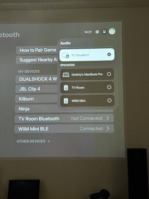

Thank you for your answer. Do you know the procedure to connect to bluetooth? Because the problem is that when I try to connect the Apple TV to the Wiim in bluetooth, the pairing is not easy as with my bluetooth headphones and when it finally tells me "Connected" no sound comes out on the speakers while it works very well in bluetooth with other devices. So I find myself forced to use the Airplay as a temporary exit that disconnects after a few hoursI have the same situation with the mini and the pro. The Apple TV connects to the Wiim but it does not detected as a sound output device. I pair an iPad with the Wiim mini and it works.

Any resolution here? I also have no sound when connecting apple tv (latest edition) to wiim pro plus via bluetooth. All other devices other than the apple tv I tried work fine.Thank you for your answer. Do you know the procedure to connect to bluetooth? Because the problem is that when I try to connect the Apple TV to the Wiim in bluetooth, the pairing is not easy as with my bluetooth headphones and when it finally tells me "Connected" no sound comes out on the speakers while it works very well in bluetooth with other devices. So I find myself forced to use the Airplay as a temporary exit that disconnects after a few hours
Same here. Hopefully there is a solution. Anyone?Hello, I have a wiim mini receiver whose sound refuses to come out once connected via bluetooth to the Apple TV although it is displayed as connected.

It doesn't look like Bluetooth is one of the supported paths even for the WiiM amp. The second alternative may work for you with the Mini as well.Hello, I have a wiim mini receiver whose sound refuses to come out once connected via bluetooth to the Apple TV although it is displayed as connected.
