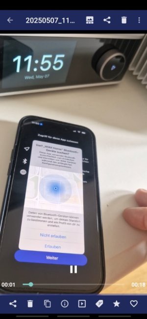

Mine asks for activation of Bluetooth for finding wiim 🤔
It doesn't look like the WiiM Home App?
I have never seen that in the app. The WiiM Vibelink amplifier do however use Bluetooth, as it doesn't have network connection.
Are you sure your phone is on the same network as the WiiM?
Wiim Home App, freshly installed on IPhone, which has never been used before.
It wants to activate Bluetooth just for finding devices. (WiiM Ultra)

I have never seen that before. I don't have an iPhone but it is not necessary with any phone as long it's on the same network as the WiiM.
Do the WiiM Home App work if you turn on the Bluetooth?
Ok. That must be a iPhone thing :unsure:
Working fine without Bluetooth on Android.

The WiiM Ultra don't use Bluetooth for setup or control. So really strange.
Newsflash...
I just tried out again that new iPhone.
Deleted and reinstalled...
Turned off Bluetooth before installing WiiM App.
It asks for Bluetooth activation, in total 2 times.
Once for setting up WIIM ultra.
Second for searching for already available devices.
Since it was deactivated beforehand, and despite choosing NO* on every activation request, the new iPhone finds the WiiM Ultra with no problems...
> so choosing Bluetooth_On is just a request, not a requirement.
Still wondering why it insists desperately to activate it, if it is not required.
And why does my older device (iPhone6) not find it, without activating...
At least my problem is solved right now.
