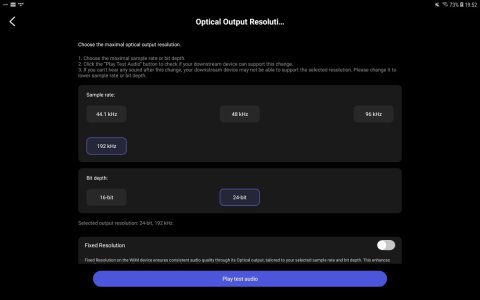

Wondering about buying and I have a dac that sounds way better in bitrates from 88.2 khz and upwards so I was wondering if Wiim-players have a way to upconvert all music to at least 88.2khz before it sends it to the dac?
Which wiim were you thinking of?
I believe all but the wiim mini support fixed sample rates.
The others support it on all their outputs, optical, coax and usb where they have it, as far as i know.
At least, all the ones I have do. :)

Thanks, you`ve been really helpful! I think the Pro will probably be sufficient then as I will be using another dac.
I understand his point too, I would have preferred if it just upconverted sources less than 88.2, but upconverting everything to f.ex 192 would be preferable to upconverting nothing
