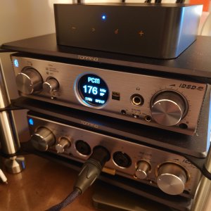

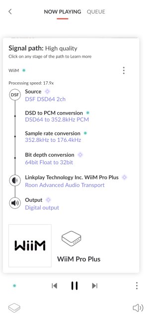

Ok. But when I connect Nucleus to ifi pro iDSD directly it shows DSD"If you see a signal path like this, where the only thing going on is DSD->PCM conversion and (possibly) a subsequent sample rate conversion, it's almost certain that Roon is converting because it doesn't think your device can handle DSD directly:"
Wiim Pro Plus can handle only PCMOk. But when I connect Nucleus to ifi pro iDSD directly it shows DSD
That’s because the Wiim reports that’s all it supports which is correct. It also doesn’t support DoP so had no way of putting out via Spdif regardless.Isn't that Roon doing the conversion before it gets anywhere near the Pro Plus?
For any DSP it will always convert to PCM so as it has a digital volume I imagine it always does, but setting to fixed should negate that.I agree WiiM should make a clear statement as to what they’re doing about DSD support on the Pro Plus
