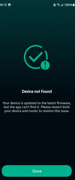

So... has anyone ever encountered this before? My pro updated just fine. Did the factory reset bit, power up/down and last but not least raised a ticket with Wiim tech support. Thanks in advance.
As it says on that screen, have you also tried rebooting your router?
Also, Please try restarting your phone as well. If that doesn't work, reinstall the app.
Problems here too. I can eventually get to the download circle but no progress and then it just times out and gives me "Unknown error". I have restarted but there is no difference in behavior.
Http api getStatusEx command is the easy way to check if there is a FW available for the device - through "VersionUpdate" and "NewVer" fields. I think that the app can see that FW for the model is available, but it doesn't verify if the device is permitted to download it.
