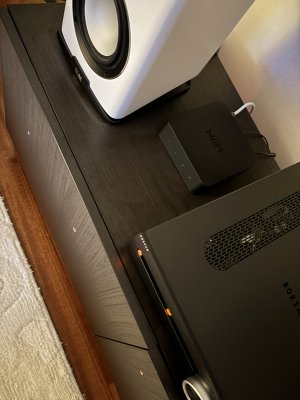

The Pro + is excellent within my setup. Please see my other posts.
