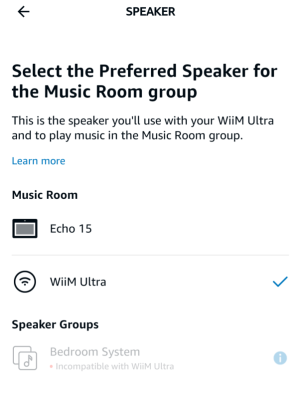

Hi
Please check the Echo show 15 device settings screen in the Alexa app. Is the Ultra set as a speaker for the Echo15?
If so, switch to the built-in speaker.

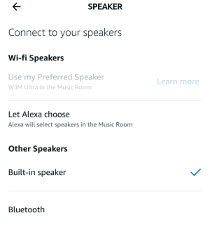

Hi,
Thank you for the feedback Wiimer.
I changed the settings in the Show to built-in speaker but still the same problem. Also tried let Alexa choose.

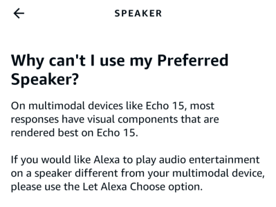

There is an oddity I had not previously noticed where it seems to be impossible to select the preferred speaker and then a dialog regarding multimodal devices.

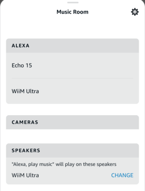

Sorry, I live in Japan, so the alexa app specs may be a bit different than in the US or other countries.
BTW, what happens if you remove Ultra from the "Music Room" group and then make Ultra the speaker for the group again?
(In my case, it works without the WiiM device in the Echo speaker group.)

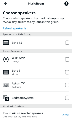

Yeah, that is strange as Alexa will normally only redirect music to a preferred speaker unless you have also changed its default speaker inputs Alexa app settings. I’d check there that your Show is set to use its own speakers, while the room group is set to use the Ultra.
Hi,
Yes I've tried and it is set.

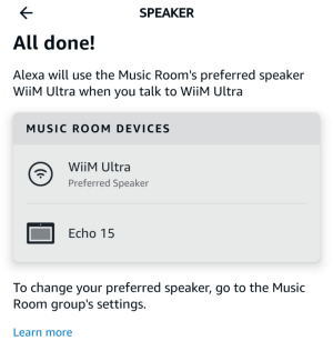

Now if I try it the other way around the preferred speaker is indeed the Ultra but only if I pass a voice commands to the Ultra itself

I’d power cycle the Ultra and the Echo, disable and re-enable alexa in the WiiM app, and maybe even log out and back in to the Alexa app. Then redo the group and its preferred speaker, making sure the Show 15 speaker setting in the Alexa app is for it to use its own speakers. That’s how mine is set up (show 15 and ultra) and all seems well.
Also, it’s not essential for the Ultra to be in the room group, so I’d try taking it out and just leaving it as the group preferred speaker. If that works, you can try adding it back in to see if that upsets things or not.
