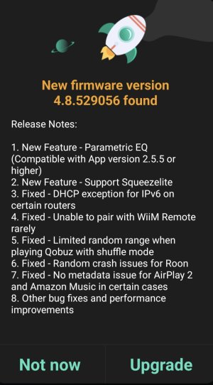

Pro's Update: V4.8.529056
The PEQ bug reported in this thread has not been fixed, so Android requires the Q value to be entered last. Also, it seems that the name when saving cannot use uppercase letters.
Squeezelite seems to have fixed skipping when track advancing/seeking.
