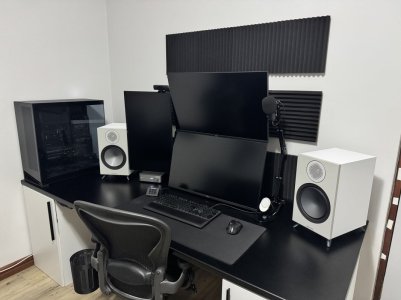

Recently swapped my Polk XT15's for the Monitor Audio Bronze 100's, got them for a great price.
These are paired up with a Polk PSW10 10" sub, that's at 60% volume, and on my Wiim Amp set to -3db's, some of the bass is coming from the MA 100's.

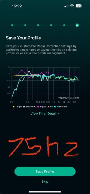

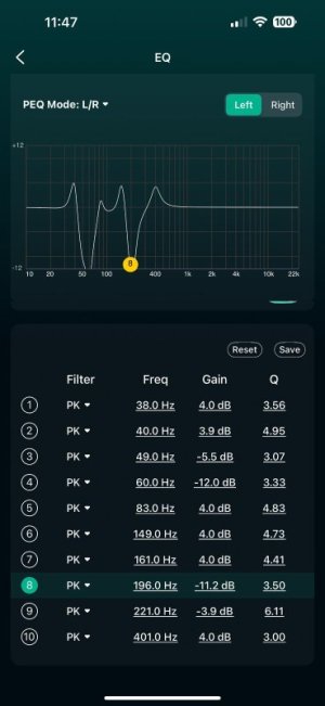

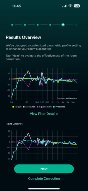

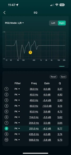

The Room Correction is giving me rather thin PEQ's, that don't sound full - As a result, I kept the EQ on flat for now which feels and sounds like the best for now on the current kit I have.

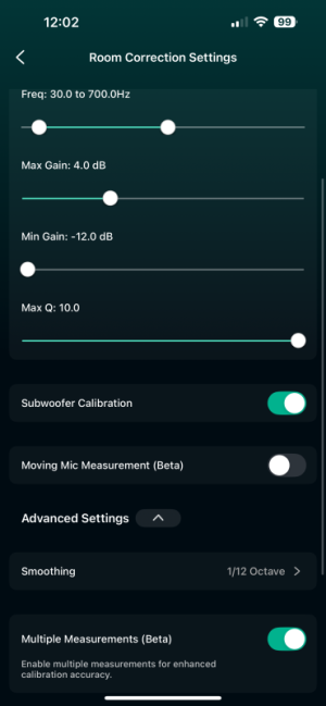

So, automatic RC gives you a thinner overall sound than no EQ at all?
Can you post your set of settings for the room correction runs? Which microphone and phone are you using?
