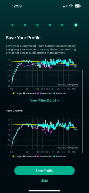

Perfect! Moving the sub around is well worth it, usually it is possible to find a spot that works better than others. It is icing on the cake if that spot turns out to be this convenient.
BTW, by turning the sub 90° you moved the driver closer to the back wall, and a bit further away from the left wall. This changed the SBIR frequencies (I explained the theory recently in this post) and in your case removed the most severe null. I also have my sub rotated 90° in my desktop system for the same reasons.
The best way to learn these effects is to experiment as you did, kudos for taking the time to do it!
I'd personally set Min Gain to -12 dB because a couple of the filters obviously need more negative gain (e.g. at 66 Hz in one channel and 64Hz in the other).
I'd personally set the lower bound to 30Hz since your sub doesn't have much output below it. Boosting below 30Hz is IMHO just wasting headroom and might result in increased distortion.
You can keep the upper bound at 1kHz if you like, but the problem areas in your room seem to all be below 300Hz.

Just note that your response now is anyway about 99% there. I'd suggest to now spend a few weeks at least listening to this setup and then see it you feel any need to tweak. It usually takes a bit of time to get accustomed to a new tuning.
Any tweaking going forward would either be more academic/educational, or should focus on fitting your personal preference (i.e. unrelated to RC). I personally wouldn't expect any dramatic improvements in objective quality of the correction itself - i.e. if you'd like you could keep it like this regardless of what WiiM do to RC in the future.

That looks pretty much perfect now, as far as room correction goes.Re-run at the above-mentioned settings that you’ve suggested
