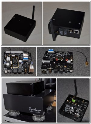

So, having been really pleased with how The Wiim Pro fits in my system, the only thing that lets it down is the plastic case. This was an itch I had to scratch!
I disassembled the unit and discovered 3 boards. I was not interested in the front switches, nor the internal DAC. Really, I was only interested in the main board, but this would not work without the DAC board, so I needed a metal box to house the 2 boards, and found a 110 x 100 x 40mm case on Amazon that looked like it would work. Also bought an external aerial.
A bit of measuring, planning, drilling and filing achieved the results I wanted, which also includes a lift in SQ!

Can I ask an admittedly (possibly) ignorant question? What does the external antennae NOT pick up that the new metal case presumably shields?
And my central air kicks on making a blowing sound. I would rather be cool than live in a isolation chamber. The case looks nice. I admire talent which you surely have.
If I understand your question correctly, I am thinking I could not reuse the original internal aerial because the new case is metal. The aerial is necessary for Bluetooth and WiFi.
I think I worded my question poorly. You wrote that a large point of the new case was to shield against stray RF/EMS noise, etc. But won’t it all just be picked up and reintroduced by the antenna anyway?
I am not an expert, but the aerial is connected with a coax cable which is shielded so I assume this would also shield against unwanted RF entering the box....
