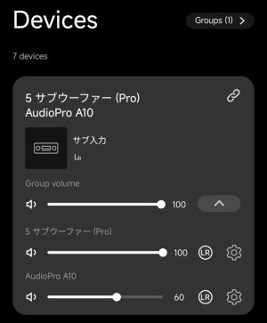

You can link the WiiM pro and A10 speakers as one group on the WiiM home app.
When music is played on the Pro (the reader device in this group) using Chromecast, sound is produced from the Pro. However, no sound is produced from the A10, which does not support Chromecast.
I don't think the A10 speakers can be linked in a Group. Yes you can link 2 devices together but not in a persistent group. I own a Wiim Pro, Audio Pro A10 (non WIIM) and soon Wiim Sound. I can link the A10 together with my Wiim Pro, however they frequently get disconnected and the order in which you access them matters. Persistent Grouping should fix that but i will be using the Wiim Sound for that.
