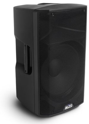

I have home a 15 inch, Alto Pro 415 speaker that Ive always used only as a sub. In my previous set up, it was plug to a 10 band EQ that got its audio directly from my mac 3.5 mm out.
Now, I mainly listen to music all over the appartement with my google nest speakers, with the TV as well ( using google TV )
The last piece of the puzzle is my big Alto 15 inch, that id like to send audio directly via steam. With this WiiM Pro. ( as I would add in the group so they all play together )

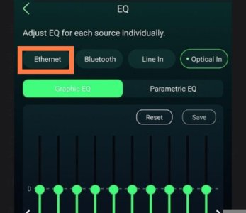

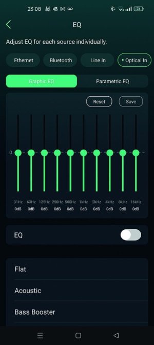

Is the digital Eq ( app controled ) in the WiiM working as well when its a Spotify Google cast stream?
Hi
Yes.
EQ settings can be adjusted for each input individually. Select Ethernet, then adjust the EQ and save your settings. This also applies to Spotify Google Cast.

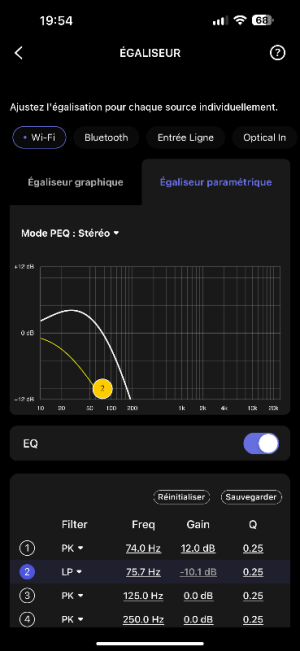

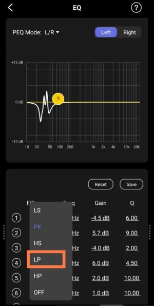

@jcmyraudio
The Pro PEQ includes a low-pass filter, so if you want to cut mid-high frequencies, you can select "LP" and set the high-cut frequency.

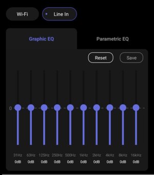

A screen shot? Meaning a printscreen of the iPhone with the EQ on the screen?
You cant save in-app the setting for that input ( and export it as a file ( .wiim )?
Yes.
For GEQ, save the graphic settings.
For PEQ, save the values for the 10-band filters.
Currently, it's not possible, but according to the WiiM team, they are currently developing import/export functionality.

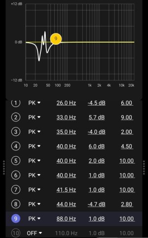

Do I copy your EQ?

In Pro, you can layer EQ over the RoomFit profile. Use RoomFit to perform room correction and achieve a flat response, then use EQ to adjust the sound to your preference.

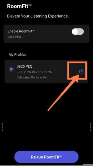

@jcmyraudio
When you run RoomFit, a profile is created on the RoomFit screen. Tap the edit icon in the list to edit the 10-band filter.
Here, you can apply an LP filter using a single band and set the crossover.
