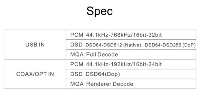

Did you check that WiiM MQA preference for external renderer are set to "renderer only" and not changed for any reason? On Topping's site, the E50 is listed full MQA on usb input only.
Thanks, "renderer only" seems to have somewhat fixed the issue. In the past, I had it set to "decoder and renderer" & it worked with MQA tag on MQA tracks...now it shows OFS tag for MQA tracks but with correct sample rate...
