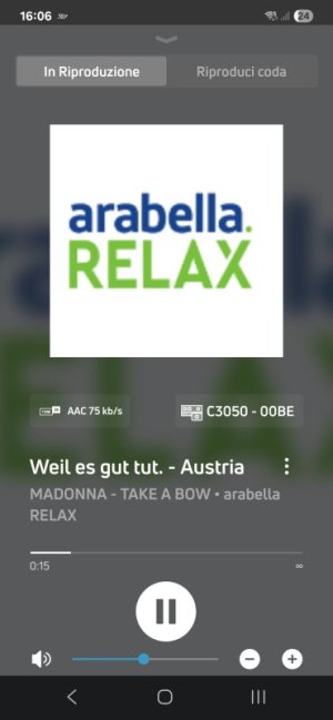

The bitrate reported by AirPlay is probably just the converted rate used by the AirPlay protocol, not the original radio bitrate?
Airplay2, except for rare cases I think also Apple doesn't know, converts anything to AAC 256Kbit.
I’d say so.

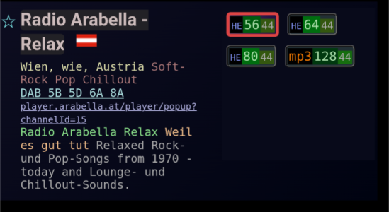

If you look for radio arabella on https://streamurl.link/ all you see are 128kbps stations. The OP could always copy the appropriate link into Open Network Stream to increase the TuneIn default rate, which to be honest doesn’t surprise me in third party access to TuneIn.

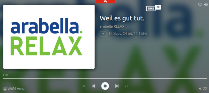

TuneIn reports 64 kbps for my setup for an audio stream:

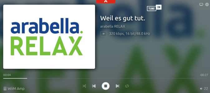

When playing a TuneIn commercial, it goes up to 320 kbps:

It depends which stream format is used. MP3 is 128, AAC is 64. AAC is meant to be better than MP3 at lower bitrates. It is annoying that radio stations don't provide AAC at higher bitrates though.
