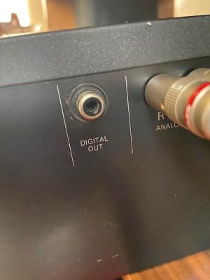

Here's the back of my CD player:

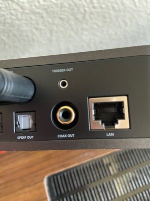

Here's the back of of the Wiim:
These are TWO OUTS.
Two OUts don't make an IN.

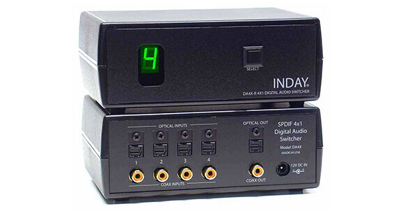

If your current DAC doesn't have a digital coax input (e.g., only Toslink and USB), then you either need a digital switcher that can handle both optical and coax, and enable input into your DAC over Toslink. Something like this:
...or get a new DAC that includes coax as well as other digital inputs. Even the inexpensive-but-excellent Schiit Modi takes coax, Toslink, and USB digital input. And it costs less than the gizmo above.

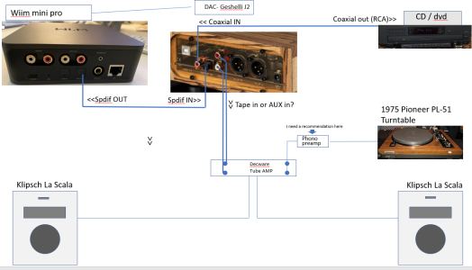

Here's a proposed setup map - does this work? - Do you have any recommendations?
That should work, but I don't see anything in Geshelli's documentation about how much output those RCA and XLR connections support. Would suggest you contact Geshelli and ask whether the J2 can serve adequately as a preamp for your Decware amp. But in terms of connectivity at least, you're good.

I'm partial to Geshelli Labs and their J2 DAC.
I've never listened to a system that included a Geshelli J2, but by all accounts it's an excellent product priced attractively. So long as it provides sufficient signal to your Decware amp, should be all good. Looks like the Decware wants at least 2v. The cursory search I did for the J2 didn't come up with its output voltage, so I suggest you contact Geshelli directly.
