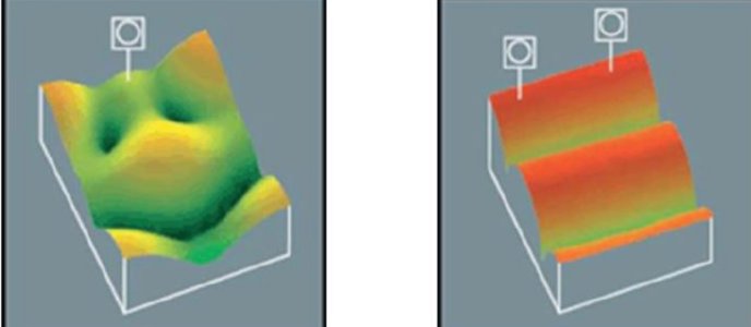

The interaction between phase, delay and reverberation time is not easy to master in itself. This is especially true when only rudimentary bass settings such as those available on Wiim devices are available. Wiim confirms this.
With two woofers, it is impossible to control the overload in the room. There is the concept of "one note bass" – a classic motor action is tapping your foot. A well-adjusted bass system is not primarily perceived as bass in the room, but rather as bass from the instrument, and it greatly helps to layer the room structure being reproduced.
Very quickly, the taste overload is perceived as correct, and we are talking here about an RT60 < 0.4 ms in the range < 60 Hz.
Side note:
What can also play a role is the master gain.
A stepless phase regulation could also be helpful.
A simple visualisation of the spatial behaviour of 1 to 2 woofers

There are two main reasons to go for dual subs:
  1. It allows you to get a smoother bass response across a wider listening area. Have a look at this presentation. This gives more flexibility with subwoofer placement, implies the bass is summed to mono, and you must be able to control each sub with DSP individually (e.g. with an additional device like miniDSP 2x4) and their parameters calculated with a software like MSO (link to guide). Subwoofers don't need to be the same model for this, but it is probably a good idea that they have similar LF extension.
  2. Alternatively, you can sacrifice the bass consistency to get stereo bass. This usually implies subs are identical, they are placed near each speaker, and you have a way to send left channel only to the left sub and right channel only to the right sub. This may be difficult to do with WiiM devices and most subs.
In either case you should be able to get higher playback levels with two subs compared to one.
