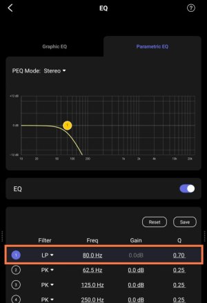

Hey Guys,
I have a WiiM Amp Pro with two Canton Speakers and a Canton Sub connected wired for my desk setup (PC connected via opt). Now I bought two WiiM Sound Lite to test something that sounded legit in my head. I want to have a second Zone in my room for DJ stuff. the two Sound Lite are the stereo speakers for zone 2 and I can control, which speaker pair i want to be playing in the WiiM Home App (just mute the ones I don't need). The sub should always play, whether the canton speakers or the WiiM speakers are playing. The DJ-Mixer is connected with RCA on the Amp Ultra.
The Speaker-Playing-Setup is working fine. It is possible to use both canton AND both Sound Lite speakers playing at the same time or - how I want it - mute on or another so that only the PC-setup OR the DJ-Setup is playing. The Problem is the Subwoofer. When I use the Wired Speakers, the sub plays. When I mute them and only the WiiM Sound Lite are used, the Sub doesn't work.
I think, the App looks at all WiiM-Amp-wired-stuff as one Group and the wirelessly connected Sound Lite Speakers as another group. When the Amp is muted, the Sub is muted too because its connected there. but I want the Canton speakers muted (or turned off) only - not the sub.
Does anyone have some hints for this case?
