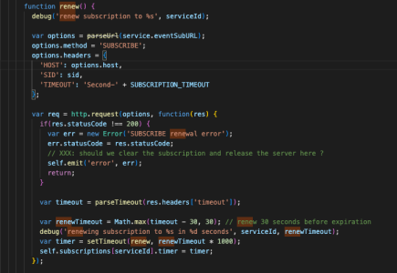

Hi,
Actually, I just wanted to use the subscription to be informed in my app when the status has changed in the WiiM device.

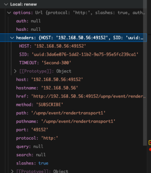

The whole code works as expected, until after about 5 minutes a "SUBSCRIBE renewal error" error occurs. After analyzing the error in more detail, it turned out that the UPnP client sends a "Renewing subscription" message to the WIIM Pro (FW: 4.8.614042) and this always responds with the message "412 Precondition Failed".
In my opinion, the message from the client is correct (see screenshots) and I have also looked at other implantations and their message structure is identical.
UPnP-Specs > see Chapter: 4.1.2 Eventing: Renewing a subscription: SUBSCRIBE with SID
UPnP-Client Code:
Request:
Response:
UPnP-Client Code:
Request:
Response:
