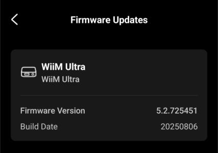

That's weird... Until this last update, that's how I was using it. USB out to DAC and Sub out was working together great. Now after the update. This recent one... USB out to DAC will not work. So I'm using Optical out to DAC.
Is the firmware version 5.2.725647?
It contains a bug fix for USB output, this may have caused your problem. Please submit a ticket.
