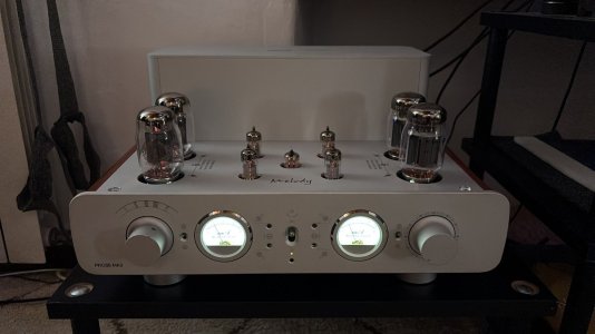

Thinking about that Topping DAC you referring to as reading many great reviews on it... Would use it behind the Wiim Ultra...
Can the Topping only be used as a headphone focused item or also as a 'normal' DAC in a home 2 channel set up with a Melody Pro88 MK2 tube amp..??
The topping has a great headphone section and can be used as a normal dac as well. I’m considering upgrading my dac to the Topping DX5 II. It’s only $300 and has awesome features as well as a better headphone section with balanced connections!
