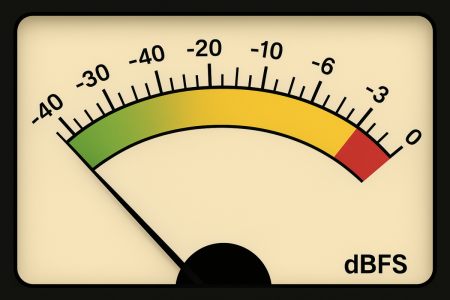

This interesting article describes the history of VU meters, including the digital meters in the end.
Although the digital meters display is usually different from the classical analog meter (as available in the WiiM Ultra), it's still possible to use that for a digital source, with just the right scale.
The question here is if @WiiM Team want to provide a useful meter or if it's only eye candy?
This image is AI generated and colors and scale is wrong (AI can't count). I do hope it shows the idea anyway.
