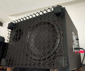

I own a Polk mxt10 and an old SW from Denon.
The MXT10 can't stand high volumes, but it's fine if it's low.
(I don't think low budget Bass Reflex SWs are basically suitable for loud volumes.)
The MXT10 is lying on its side with the unit facing forward. I put it at a height close to the ceiling, not the floor.
To protect the speaker, we installed a cat repellent net. 🙀🤣
