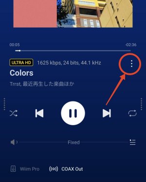

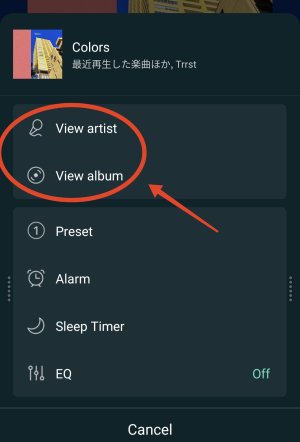

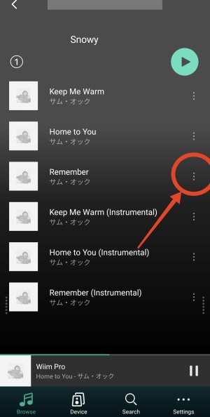

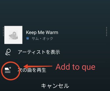

Thanks, my terminology is incorrect. I use Airplay, never Bluetooth. The WiiM Home app is linked to Alexa. As far as access to the libraries of Qobuz or Amazon when using the WiiM Home app, there are certain artists albums that are not available whereas on their apps they are available. Also I have not figured out how to add an album to the que when using the WiiM app, never a problem when using their apps. So, pain in the rear, probably because I have not figured out how to do it.
