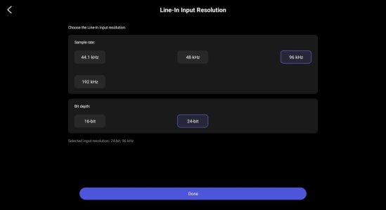

It's set to 16/44.1 because it's coming from the cd player. Is that wrong?
There are a number of posts / measurements etc. (somewhere!) whose conclusion was (as I understood it) that 24 bit / 96khz is a sort of sweet spot in the adc setup.
24 bit instead of 16 bit was the primary reason.
If no one else posts a link to those posts I might have a hunt for them.
Or just trust us ;)
