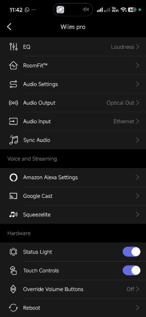

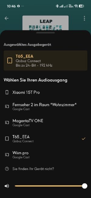

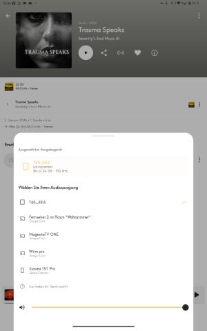

Happy New Year, everyone. I'm having a big problem with my Wiim Pro. Until three days ago, I was able to work perfectly with the Wiim Pro and Qobuz via Wiim Connect. Unfortunately, this no longer works. I use a tablet and a smartphone to stream. When I try to connect the devices via Wiim Connect, the respective smartphone is listed under the device selection. When I want to connect via the tablet, the smartphone is listed as the Wiim Connect device. With the smartphone, it is the tablet. The audio output is then played through the respective device and not through the Wiim Pro. I have already reset the apps and reinstalled them, but without success. I'm slowly getting desperate. I actually wanted to upgrade to the Wiim Amp Ultra, but I'd rather not do that for now.

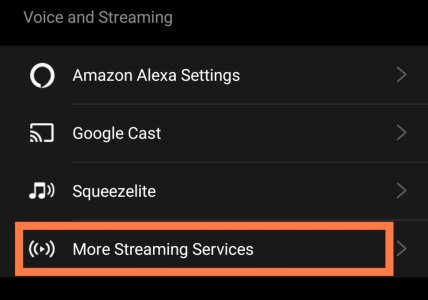

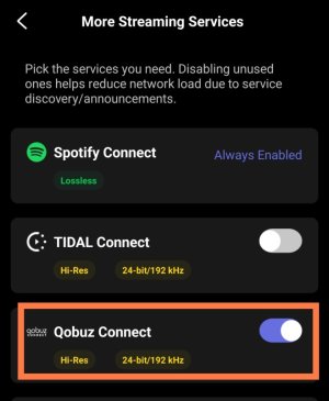

Hi
Open the Pro device settings in the WiiM app and verify that Qobuz Connect is turned on.
Gear icon > More Streaming Services
Thank you for your reply. Unfortunately, there is no "More Streaming services" option.
This means that your firmware, or app are not up to date.
